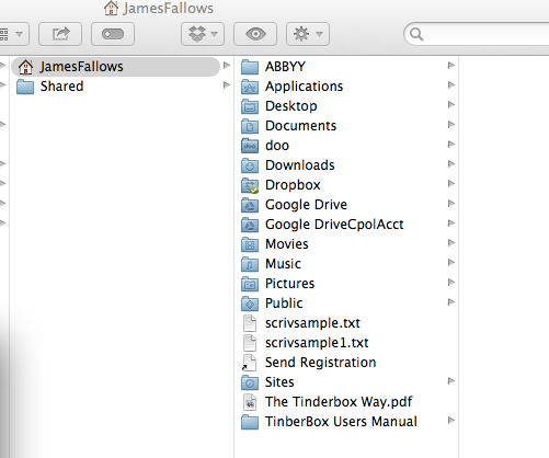

I have run into an odd obstacle that I hope has an easy / "D'oh!"-type explanation. I cannot find a Services folder in the place suggested in your how-to sheet.
Here is what the how-to sheet says:
Quote:
Unpack the zip file and locate the file called 'Clip Selection to Tinderbox.service'.
copy or move this file to:     ~/Library/Services/
Or, in longer form the path is:
  /Users/[short name of user acc]/Library/Services/
If the 'Services' folder doesn't exist in your Library, add one.
Here is what the relevant part of my disk structure looks like. [Correction: for the moment I can't get a screenshot photo to post. What it shows is no Services folder in the places one would expect.] When I try to create a new Services folder in this hierarchy, it tells me that's forbidden, because that name is taken.
So obviously there *is* a services folder somewhere, (a) because the system tells me the name is chosen, and (b) because some services (for DevonThink, Scrivener, LastPass, etc) do come up properly now.
How can I force the Scripts folder to reveal itself, so I can copy your utility into it? I am sure the answer is obvious, but it's not yet obvious to me.
Here's the picture of how that part of my directory looks:
And a little more detail FWIW:

To find your Services folder:
1) In Finder, press and hold the OPTION key.
2) From the GO menu, select LIBRARY. (The Library folder is normally hidden).
3) Scroll down to the Services folder.
Back to top
WWW   IP Logged

Reply #12 - Sep 17th, 2014, 4:45pm
Ahah!  Thanks for the tip!
(This does seems a Windows-type trick to pull, ie hiding certain folders unless you know to push the Option key. But I digress.)
Appreciate it.

This sort of OS obfuscation can also be overcome by dragging the Library folder (once exposed in Finder) into the finder left sidebar where is becomes a shortcut as for Pictures, documents, etc. I guess it depends how often you use you Library.  Smiley
