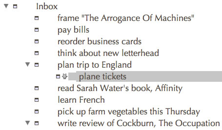

Let's use Tinderbox to make a big ToDo list, a comprehensive list of everything we want to do. The recent popularity of comprehensive ToDo lists was inspired by David Allen's book, Getting Things Done; we wont adhere to every detail of Allens system here, but GTD fans will find this approach familiar.
To begin, we'll open a fresh Tinderbox outline and start making lists of some things we want to do. We can do this very quickly: hit to make a new note, enter its title, hit Return to finish the note and we're ready for the next task.
We're done
We're done. You could use Tinderbox effectively in exactly this way, with no further elaboration. You can add notes for new tasks. If you need to explain the task, you can write as much as you like inside the note. If a project needs to be elaborated if it turns out to contain lots of subtasks you can easily put the subtasks inside the project to keep everything organized.
